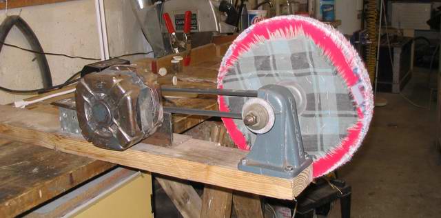

Here is my homemade version of the buffer.
An cloth washer motor and a single buff. As simple and cheap as it gets!
I do not mean to say this is better, but for a low budget and 1 instrument per year it get the job done.
Buff is also home made out of old flanelle shirts. This is not the best however.
An improvment I will do is to position the end "thing" (not too sure how that is called)at 90 degree so I get more cleareance
It clamp to the workbench or I put it in my B&D workmate when used. When not used it goes under the bench.

i've seen canton flannel buffs and other sorts of flannel buffs but this is the first time i've seen "bubba" flannel buffs!!!!!!
great idea alain
PostPosted: Sat Aug 12, 2006 8:22 am
Very cool buffer Alain!

[QUOTE=crazymanmichael]this is the first time i've seen "bubba" flannel buffs!!!!!!
Bubba ???
